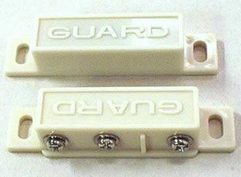

So let me get this straight. Connect the negitive trigger wire to the N/C connection on the reed switch. Then the ground wire to which connection on the switch?  I make these connections without the second half of the switch?
Posted By: dlm876
Date Posted: August 17, 2005 at 10:52 PM
 I Understand about connecting the trigger wire to the NC connection on the switch only.  The ground wire is what confuses me.  Does the ground wire connect to the same as the trigger wire? When you say input do mean the NC connection? here is a picture of one? im lost!posted_image
Posted By: dlm876
Date Posted: August 17, 2005 at 11:02 PM
Now I got it! Thanks a million!!!
