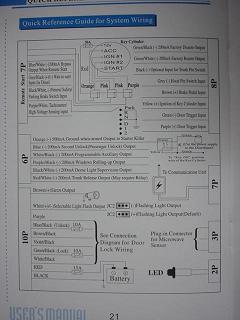

Date Posted: November 11, 2005 at 11:49 PM
posted_imagescreen shot of manual

Date Posted: November 12, 2005 at 12:03 AM
Better picture:
https://69.94.91.23/ebayimages/king-eagle-manual-big.jpg
Shows Page 21...............What happened to others

Posted By: gidy.up
Date Posted: November 12, 2005 at 12:11 AM
others are in the manual, that is the quick reference page, unless you need all the step by step wire hook-up it is the same
