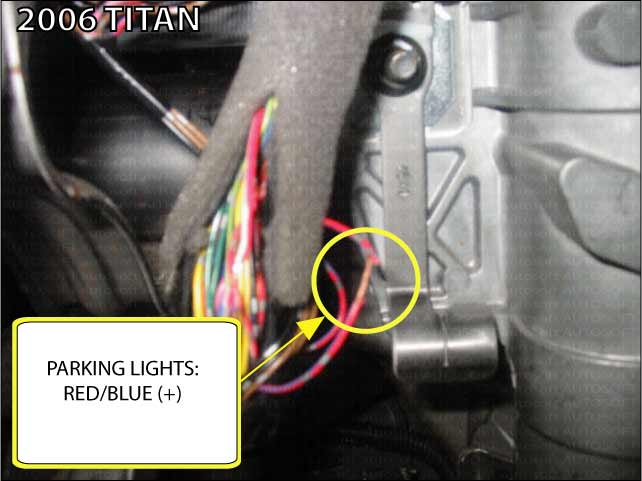

Posted By: dea,can
Date Posted: August 30, 2006 at 4:28 AM
posted_image
dragon
Posted By: dea,can
Date Posted: August 30, 2006 at 4:41 AM
if u find that ball of wires that maybe your ticket can't be  more easy then that my sharing secrets are all out

Posted By: gcorrea
Date Posted: August 30, 2006 at 7:57 PM
that the wire im using, it flashes the parking lights , but just wondering why it wont flash the instrument cluster. it also only flashes climate control knobs. know what i mean. does tapping it at the kick panel like you said flash the cluster?
