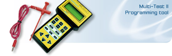

I use the multitest 2 to program and check errors in programming. (astros version of the bitwritter) Those dip switches are a pain.....

Posted By: master5
Date Posted: October 21, 2006 at 12:10 PM
Ahhh......So astrostart is on top of it's game.
Good to know.
