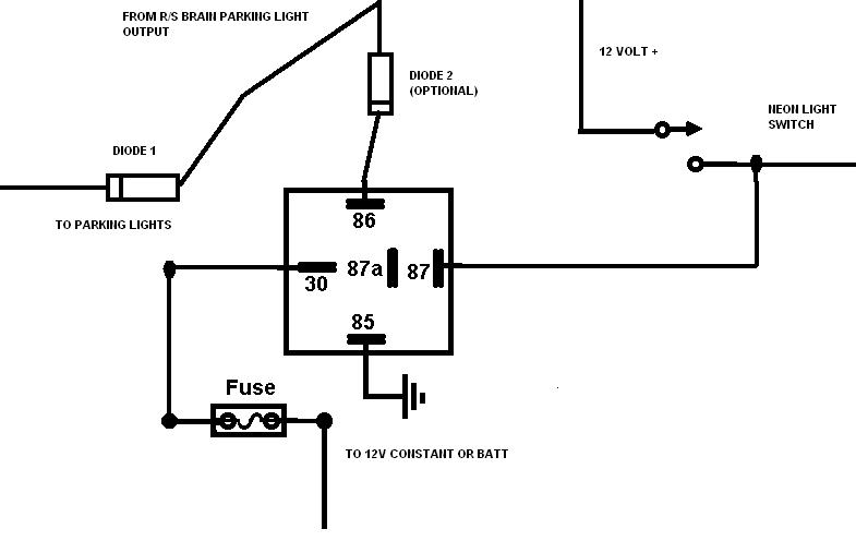

Yes, simple. If you use diodes with enough amperage rating for your parking lights, this is how:
Take the 12+ lightflash wire from alarm and use both diodes. Twist the anodes (side without the stripes) and connect that to this wire.(12v + parking light output) You will now have a "Y" with 2 diodes, stripe sides out. Put a wire on each. Run one to where you normally connect the parking lights from the alarm, put the other to a relay..pin 86
pin 85...ground
pin 30 12v constant seperatly fused power source.
pin 87 to the 12v + power wire of the neons.
This will allow the neons to flash with the alarm and parking lights, but will prevent your parking lights from powering up the neons (they are now isolated) and vice-versa.
If you need a diagram let me know. I can't do this here (at work) but can at home.
Any questions post.*
* If you can't find a diode large enough, you can connect more then one in parallel to increase the overall rating. Ex: 3, 3a = 9a etc.

I have my neons connected direct to my parking lights as the power source with an inline switch, if the switch is on my neons will turn on with my parking lights, if off my park lights can be on w/o my neons. They will flash and also stay on after flash as my alarm keeps the parking lights on for about 30sec after unlock. I see no need for a relay or a diode.
Posted By: master5
Date Posted: October 27, 2006 at 8:42 PM
Without diodes or relay isolation what is preventing the parking lights from lighting when you power up the neons?  Maybe while at a "show" or something he only wants the neon lights on. Isin't it nice to have that choice for only a few dollars in parts?
And also, I would be concerned running neons AND parking lights straight off the systems output, but if the total combined current of the parking lights and the neons do not exceed the rating of the alarm system (usually 10amps) then I guess you could do without the relay. I just prefer to lean towards the safe side, a relay is cheap enough.
Technically, you really only need the diode on the parking light side since the relay for the neons will isolate it. Once again, just being extra safe, a diode is cheap as well.
If you wire it as I explained and connect the relay output to the neon power AFTER the neon switch, everything will work normal and as you want, without ANY chance of a problem. The parking lights will work normal and independant, the neons will work normal and independant, and the alarm will flash them with the parking lights as you requested.
Ok...NEXT..DO NOT install a remote start onto your manual trans vehicle unless the unit or an interface is designed specifically for a manual trans. That is all I will say on that topic so I don't get blamed if the car one day by accident drives through someones house..I want no part of that..lol
As far as any dvd or course on installing a remote start...well lets just say it can't hurt. Written a few myself. The thing is if it is not showing how to install it on your specific vehicle, and you are not experienced, it could spell trouble. But since it is your car, if you are willing to take the risk, it is the best way to learn. This way if you do mess something up theres no chance of you sueing yourself. Just be extra careful..use a DMM, make "solid" connections...don't connect to ANYTHING until you verify what it is, and ask for help if needed. (WE are here to and glad to help).
I don't think it matters if you use an LED kit or not as far as the flashing, I have used both this way with no problems. However, the leds use less current so if not using a relay there is less risk. Some real "neons" use a decent size transformer, hence the concern with using a relay. Your choice but if it blows the fuse on the alarms lightflash output, don't blame me. And if you put a bigger fuse in to compensate, and it burns the output..again, don't blame me.
I will post a diagram later, I have to do it by hand as I don't have this circuit on file.

It is a simple diagram so perhaps someone else can post it, As far as the size fuse and diode(s) you need just look at the fuse that came with the neons. If its a 5amp, you should use a 5amp fuse on the relay, and a 5 amp diode or put 2-3a diodes together.
If you don't want to use a diode I can tell you how to do it with another relay instead.

Diagram to flash neon with alarm (isolated w/ relay/diode)

Oh well, anyhow if you follow that diagram I posted it will do what you want in a safe way. Make sure that you have help from a qualified installer when doing the RS so you will learn the correct way. You don't want to blow up another sound system or worse.
