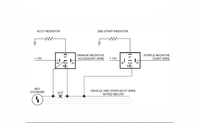

Posted By: master5
Date Posted: November 22, 2006 at 10:48 PM
I have not come across this problem but I found out some info, perhaps it will help. I can't say for sure but it is odd so figure I'd post it regardless.
12volts  lt. blue/red (2A)   +   ignition harness
Starter  dk. GREEN/ YELLOW   +   ign harn or starter button (SRT-10)
Second Starter  PURPLE / brown   -   ignition harness
Notes: The second starter wire is negative trigger thru an 180 ohm resistor. MUST use a relay.
Ignition  pink/white   +   ignition harness
Second Ignition  N/A
Third Ignition  N/A
Accessory  same as second starter wire   -   ignition harness
Notes: The accessory wire is negative trigger thru a 610 ohm resistor. MUST use a relay.
posted_image
