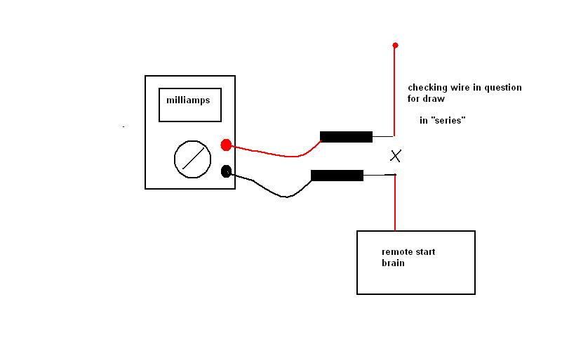

Ok you need to do whats called a current draw test. You must connect a DMM in series with any power wires in question..as well as any relays to check the draw. See diagram...
Now a normal draw will be 7 to 10 millamps for the entire vehicle when parked , doors shut and key off...up to 20 millamps is acceptable. Any more then that could definatly kill a standard battery overnight. If a relay is miswired and the coil is energized while the vehicle is parked..it is about 150ma..that is a problem. Once you find the wire, circuit or relay that is drawing the excessive current..post back if you can't figure out why and we will help. There are way to many variables for anyone to "guess"correctly what is causing this.

Well guys i found the problem its a relay that i installed to turn on my aux lights with the remote,that current test works wonders.......Thanks for all the helpposted_image
