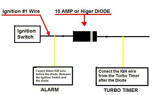

Posted By: turbo_boss
Date Posted: December 27, 2006 at 8:45 AM
Ok, I have inatall several Turbo Timer with alarms.  Get a 10 amp diode and cut the ignition wire thats come from the ignition switch and hook there the 10 amp diode.  Then conect the wire from the alarm between the ignition switch and the diode and the wire that comes from the Turbo timer after the diode.
Hope you undertand my explication.
Good luck,
Isaac
Date Posted: December 27, 2006 at 3:47 PM
posted_image
You can use a 10 AMP or higer value diode.  You can but the diode in Radio Shack.  10 AMP or higer Diodes are incased in metal and does not look like the regular black ones.
