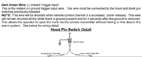

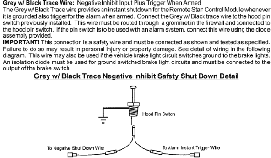

Hey. Im installing a presteige alarm and im having trouble understanding how to work the hood trigger wire. I attahced 2 images out of the manual. Theres 2 ways to hook up the trigger as fas I can tell. I have it hooked up the 1st way, but only using the alarm instant trigger wire from the alarm module, i cant figure out where or what the negative shut down wire is? Can someone help?

Posted By: brhaugen
Date Posted: February 08, 2007 at 7:21 AM
Use the gray/black wire it will do both rs shutdown and alarm trigger
