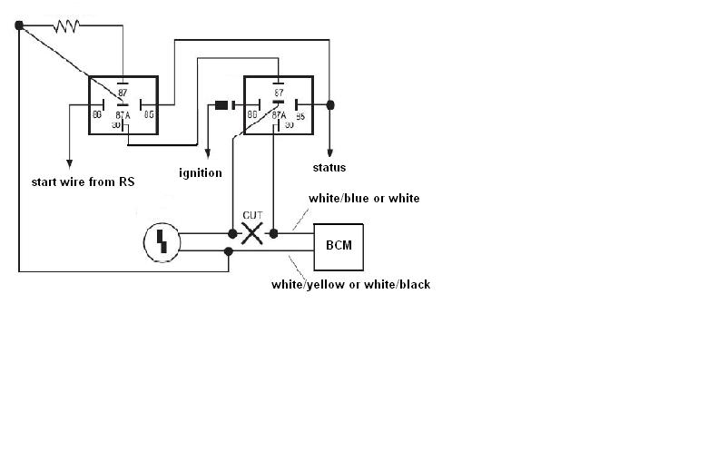

06 h3's you can just build the 2 relay bypass and it works flawless.  I couldn't get the bypasses to work either.
Posted By: custom audio ny
Date Posted: March 21, 2007 at 9:34 PM
If you don't know the 2 relay bypass this is how i do it.
To get the resistor value start the vehicle with the key.
Cut the WHITE/ blue or white wire and use a DMM. Measure the resistance from the key side of the wire you cut to the WHITE/ yellow or white black wire while the key is in crank position. The vehicle has built in anti-grind.
Follow this diagram.
