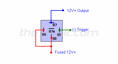

The green wire is your problem it's for starter kill/anti grind.  There should be a small harness that plugs into the relay pack that has a purple, orange, pink, and blue wire coming off it.  Use the purple wire and hook it up to a relay and use that for your second starter wire.
posted_image
