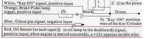

I installed the passlock interface, but nothing happen, this is the diagram, do you know the color of the sensor oil cable?

Posted By: djmonchi
Date Posted: July 31, 2007 at 12:18 PM
I got it dude, this is what i found, i did not installed 555l correctly installe it under the dashboar but i fanilly found the passlock is next to the Key Cylinder, so i cut the cables and made the connections again and is star, but i have a new problem the starter still cranck when the engine is running, theres is a cable on the alarm system (direct to the oil sensor to stop the remote star when the engine is running do you know where can i connect this cable?
Mr.Perez
Posted By: swerks
Date Posted: July 31, 2007 at 5:04 PM
good show!! do you mean that you are looking for a tach signal ive never heard of a starter that uses oil pressure signal to tell that it has started. tach for your s10 is white or PURPLE / white at the coil on top of the engine. Im quite sure you mean coil not oil

Posted By: djmonchi
Date Posted: August 01, 2007 at 1:05 PM
No, it is oil sensor. check this out.
posted_image
Mr.Perez
Posted By: swerks
Date Posted: August 01, 2007 at 3:01 PM
not to sure what kind of starter that is looks kinda cheap but anyways it says it is also the tach input which i strongly reccomend using it as it will proball have to be progammed for tach end me a email and ill send you a wire chart for your s10. good luck!!!
