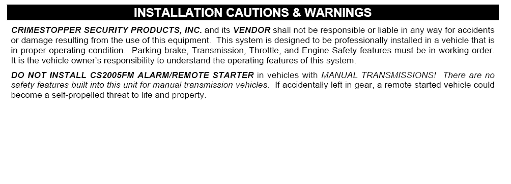

Posted By: moonliter
Date Posted: November 16, 2007 at 4:40 PM
mrdeep2001 wrote:
Regarding the remote start, I was told that someone was messing with the key fob and started the car. The car was in gear and it took off and hit another car. After that, the remote start didn't work.
Your mustang is manual transmission. Your crimestopper rs is designed for automatic transmission. That is why it took off when it was remote started when it was in gear !
Read the warnings in your crimestopper's manual
posted_image
Posted By: mrdeep2001
Date Posted: November 17, 2007 at 1:11 AM
1. I did NOT install the alarm/remote start
2. I DID read that.
