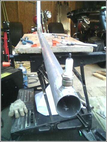

Old Mechanic is right...but he forgot one thing......how to make the coils spark. There are a lot of ways to do this. And these devices are the heart of most of the flamethrower kits that you find out there. I have a great system that I just built for my old 1981 shovelhead. Take a look.
