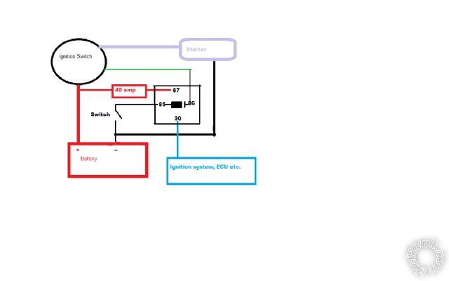

Here's a simplified diagram using a relay and a single pole on-off switch.
The black wire to relay 85 can be a thin gauge and the switch can be low current. The quenching diode, actually not needed in this method though for safety etc. is a 1N4004. The relay is a standard automotive relay I showed a 4 pin but the more readily available 5 pin can be used, just don't use 87a.
The 40* amp fuse is mandatory, you can earth the black to any good local earthing point though I've shown it going back to the battery for convenience.
Car parts suppliers, Maplin etc. hold all the parts.
The switch must be on/off latched NOT momentary.
This will shut down your engine immediately.
*Measure the current draw across your ignition circuit.
Posted By: ba249k
Date Posted: August 17, 2014 at 2:38 PM
Hi Howie
Thanks for the quick reply.
With this we would have a open / closed isolator switch at the positive battery terminal.
By opening this isolator would that kill the engine?
In your diagram where you have 'starter' would that be the Alternator?
Would you pass the return from the Alternator through a resister to earth?
Posted By: howie ll
Date Posted: August 17, 2014 at 3:20 PM
No it's the starter did I mention alternators?
Forget the alternators it's irrelevant.
To stop a petrol engine, interrupt the ignition. That's it.
Why add complications?
Resisters, alternators? Why over complicate things?
