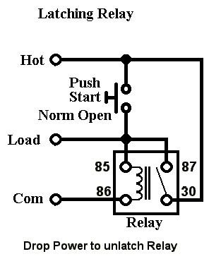

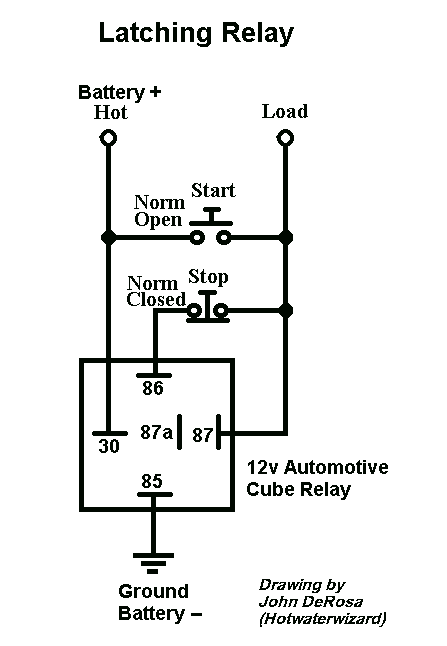

I think we can do this with relays.
Here is a basic circuit we will start with. I made this a couple of years ago.
posted_imageposted_image
