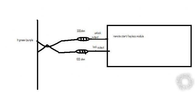

ok so I only tried connecting the Door Unlock/Lock and Trunk, since I have to wait to receive the bypass module. when i press either the lock or unlock button on the remote, all it does is lock the doors. What could i have done wrong that is not allowing me to unlock?
Im going to upload a picture of how i did the wiring.posted_image
could it be that i twisted both ends of the resistor and connected them at one splice as i didnt want to cut twice on one wire???
resistance changed when twisted together?

If the KE system has only two wires you need relays.
Posted By: kreg357
Date Posted: February 24, 2012 at 5:47 PM
Not familiar with the Avital 4103 unit ( not one of my normal brands ) but as Howard points out, using relays will definitely solve your problem.  Here is a link to the relay wiring :  https://www.bulldogsecurity.com/diagrams/extrainfo/diagrams/14301_SEBRING-SEDAN_JBS%20UNITS%201%20WIRE%20DOORLOCKS.JPG   Use the top diagram.

The 778 is a pre-wired pair of relays from Bulldog Security ( kind of like the DEI 451M ) and the 775 Relay is just a single 30/40 Amp SPDT relay ( standard Bosch 5 Pin automotive relay ) with harness.
Yes, you can use SPST relays ( 4 pin ) for that door lock application.

I'm confused.  Originally you were installing an Avital 4103 and using relays for the locks.  Which Remote Start / Keyless Entry
system did you actually buy / install?
The 451M kit comes with a 330 ohm resistor.  Radio Shack will have the 100 ohm resistor.  Follow the Type H wiring diagram on
Page 6 of the instructions.  You can test this with just the 451M connected to the car and applying +12V to the Red wire in the
3 Pin plug and a momentary ground to either the Green or Blue wire for lock or unlock.  If that works properly all the time, then the
issue you mentioned is with the R/S keyless entry system.

Using this 4103 Install guide ( https://www.the12volt.com/installbay/file.asp?ID=738 ), it looks like you only need to
connect H1/8 to a solid chassis ground, H1/9 ( factory default is + ) to the Sebrings WHITE/ Violet Parking Light wire
in the DKP ( optional ), and the two heavy gauge Red wires to a +12V constant source from the 6 Pin connector for
keyless entry functions.  Also connect the Antenna and 451M to their respective ports.  The factory default programming
of single 0.8 second pulses should be OK.
If you have a spare 330 ohm resistor, you could test the system locking by making a jumper wire with the resistor in
the middle.  One end to the cars Lock/Unlock wire and momentarily touch the other end to chassis ground right after
engine turn off.  Could be a poor connection in your wiring that is causing the problem.  Everything should be soldered
and the chassis ground wire should have a soldered on terminal ring and be securely fastened to bare metal.

ok so i went off of the 8528 manual because my computer wouldnt let me press go. but just now i tried to open the 2568 and it shows the remote start wiring different. im giessing thays the reason it wont start
Posted By: kreg357
Date Posted: March 28, 2012 at 1:58 AM
Probably.  If the box has the guide number of 2568, that is the one you want to use.  Looks
like you should follow the Section B, Type 2 diagram.
If you had the ADS USB cable and access to the firmware downloads, you could re-flash the module
with the newer ADS ALSL CH5 firmware and leave the wiring as per the guide #8528 Type 3 diagram.
Don't forget to follow the Install Mode procedure ( Standard Mode - two blinks ) on Page 18
and then the 9 step vehicle programming procedure.

i rewired, i hear the box clickibg when i press remote start but car wont start. i checked the voltage on every wire and they all have power. do i have to connect the 4 pin satellite harness for the avital?
Posted By: randroids
Date Posted: March 28, 2012 at 3:50 PM
i did the shutdown diagnostics and it blinks in a pattern of 3, low or no RPM , low battery(for voltage & virtual tach modes)
Posted By: kreg357
Date Posted: March 28, 2012 at 5:05 PM
Just so we don't miss anything, lets go step by step.
1. You connected the ADS ALSL CH bypass module to the Avital 4103 W2W as per the Section B
Type 2 install diagram shown in guide #2568. ( Diode is a 1N4001 or equiv.)
1a. On the 4103 4 Pin Satellite Harness, only the Blue (-) 200ma Status Output wire is
used.  It must be connected to the bypass module Blue/White GWR Input.
2. You set the install mode on the bypass module to Standard ( two blinks ) and locked it in.
3. You did the 9 step bypass module to vehicle programming on page 17 of the guide and it
responded properly and appeared to complete the programming OK.
4. As a test, you can now use the Avital FOB's to lock, unlock and pop the trunk.
If all of the above is good, the error indicates a 4103 issue. ( same avital warning )
Things to do / check on the Avital :
1. The bypass supplies a Tach signal to the 4103.  (You connected the wire. ADS PURPLE / White
to 4103 H2/2 PURPLE / White)  Did you program the 4103 for Tach Mode? Menu 2, Item 1, Opt 4
2. Did you do the 4103 Tach Learn process?
  To learn the tach signal
  1. Start the vehicle with the key.
  2. Within 5 seconds, press and hold the Program switch.
  3. The LED will light constant when the tach signal is learned.
  4. Release the Program switch.
