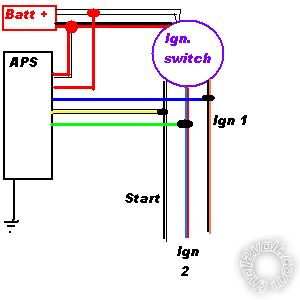

Here's the simple set-up, wiring by follow the colour:-

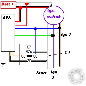

And this one adds the starter cut/anti-grind relay:-

Please note:- If they supplied the relay, complete with base and diode if the band on the diode goes to 85, don't worry, just wire the 85 to ignition 1 and the 86 to Ground when Armed, aka GWR orange wire.

Posted By: howie ll
Date Posted: April 02, 2013 at 11:16 AM
Cut starter wire, key side to 87a.
other side + yellow from APS to 30.

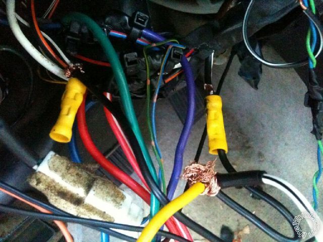

Here are my connections. On the relay the stripe points to 85 which is the red wire. The yellow connectors are the two ends of the starter wire.

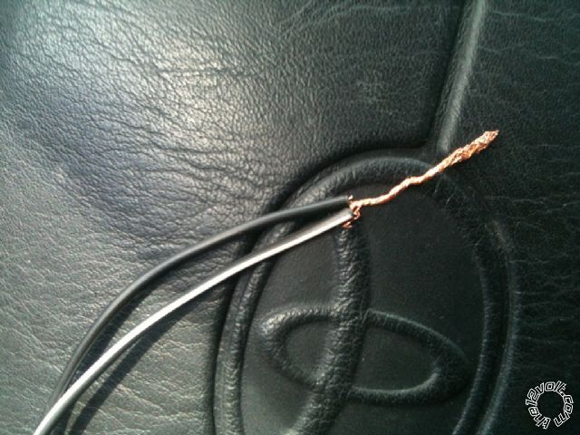

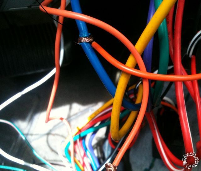

Sorry I forgot to say that in the 2nd pic it shows 86 to ignition 1 and 85 to GWR I currently have it wired 85 to ignition and 86 to GWR but I was testing both ways and still no luck. Also for the starter on/off switch wires I twisted them together. I tested for +12v on one of the wires and it was live, but once the two were joined together I got 0. Below is what I did. Should they remain as is or do I need to connect them to any other wire? Depending on which wires I get a click from the relay but no remote start response still. My car came with an Automate III alarm which is a DEI product. I removed that because I bought the car with no fobs and it was not hooked up. Could there be another relay I dont know about. I checked under the hood in the fuse box and there is a starter relay there. Could that be some sort of factory starter shut off that gets switched on only when the key is turned to the on position?

On second thoughts don't take it to a pro, they'll take one look at your wiring and say "who did this?"
It's an awful mess.

WOW. A picture IS worth a thousand words.  It seems that this remote starter is not going to work for you. It seems that something is missing from your install that unfortunately we can not see based on your info.
It should be a easy install...1 Starter, 2 Ignitions, 1 Accessory. .. Along with door locks, Tach, Brake,  ect, ect...
Or maybe you have a dead unit.  Put you car back the way it was.
Get a Viper 5701, Clifford 3.3 or a Python 872. (All the same system that I am more familar with)...All three are remote start/alarm systems.  It might be easer for us to guide/help you to your install.
Also, dump the crimp connectors and get a solder gun and solder your connections.
