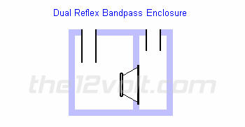

	<DIV ALIGN="center"><SPAN STYLE="font-size:12pt; font-family:arial; font-weight:bold">Sixth Order Enclosures</SPAN></DIV><BR><BR>
    <CENTER><IMG SRC="../images2/quasisixbandpass.gif" WIDTH=350 HEIGHT=182 BORDER=0></CENTER>
	<CENTER><IMG SRC="../images2/isoquasi6bandpass.gif" WIDTH=350 HEIGHT=182 BORDER=0></CENTER>
	<CENTER><IMG SRC="../images2/dualrefbpass.gif" WIDTH=350 HEIGHT=182 BORDER=0></CENTER>

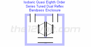

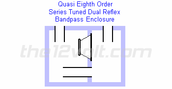

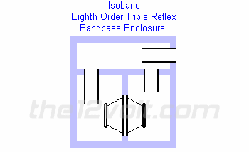

	<DIV ALIGN="center"><SPAN STYLE="font-size:12pt; font-family:arial; font-weight:bold">Eighth Order Enclosures</SPAN></DIV><BR><BR>
    <CENTER><IMG SRC="../images2/quasi8dualbpass.gif" WIDTH=350 HEIGHT=182 BORDER=0></CENTER>
	<CENTER><IMG SRC="../images2/isoquasi8dualbpass.gif" WIDTH=350 HEIGHT=182 BORDER=0></CENTER>
	<CENTER><IMG SRC="../images2/8tripbp.gif" WIDTH=350 HEIGHT=214 BORDER=0></CENTER>
	<CENTER><IMG SRC="../images2/iso8tripbp.gif" WIDTH=350 HEIGHT=214 BORDER=0></CENTER>
