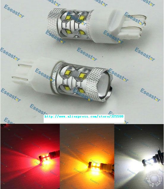

The 7443/3157 lamps have two contacts, have strong light and dimmer light. when open the headlight, the dimmer lamp light on, when brake , the strong light light on( more light than driving) so others know brakes , can stop.One bulb has two funtion.Our online shop are specialized in various kinds of leds.

This is the photo of 7443 LED.posted_image
