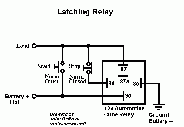

Iam building a custom motorcycle that has most of the normal parts hidden in effort to keep with this theme iam trying to wire in a keyless ignition switch i have a keyless entry alarm that sends a pulse for on and another different pulse for off , I need a dual latching 12 volt relay that is small because i have no room to work with. I dont want the same button to turn the bike on and off. Ive found the relay i need from tyco industries but i havnet been able to find anyone who carrries it. PLease Help

posted_image
you can use a standard Cube Relay.

You can Eliminate the normally closed switch if your power lead is switched.
Jost put a wire there.
When the power is turned off to the relay it will automaticly unlatch.

Posted By: moto-x
Date Posted: November 05, 2004 at 4:54 PM
that wontwork  the remote sends a single pulse for on and a single pulse for off there isnt a constant signal

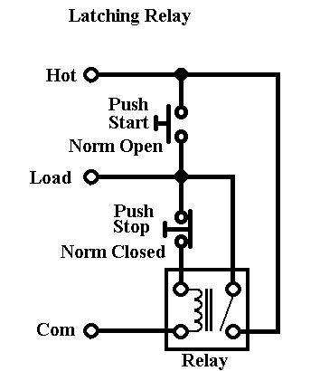

Hotwaterwizard;
What software did you use to design the relay diagrams if you don't  mind me asking? Does it matter if you wire the 12v hot from a power source/ battery  to the 30 or 87 tab or do they both accomplish the same thing if your trying to turn something on from a switch or ignition only source?
Posted By: hotwaterwizard
Date Posted: November 17, 2004 at 4:15 PM
Yes it does matter which one but, you could switch the Ground and Hot if you need a Negitive Latch.
Here is a Different View of the same circuit.posted_image
Date Posted: November 17, 2004 at 4:23 PM
I use MS Paint to Draw all of my Diagrams.
If you want to switch the wires you can do it this way.posted_image
