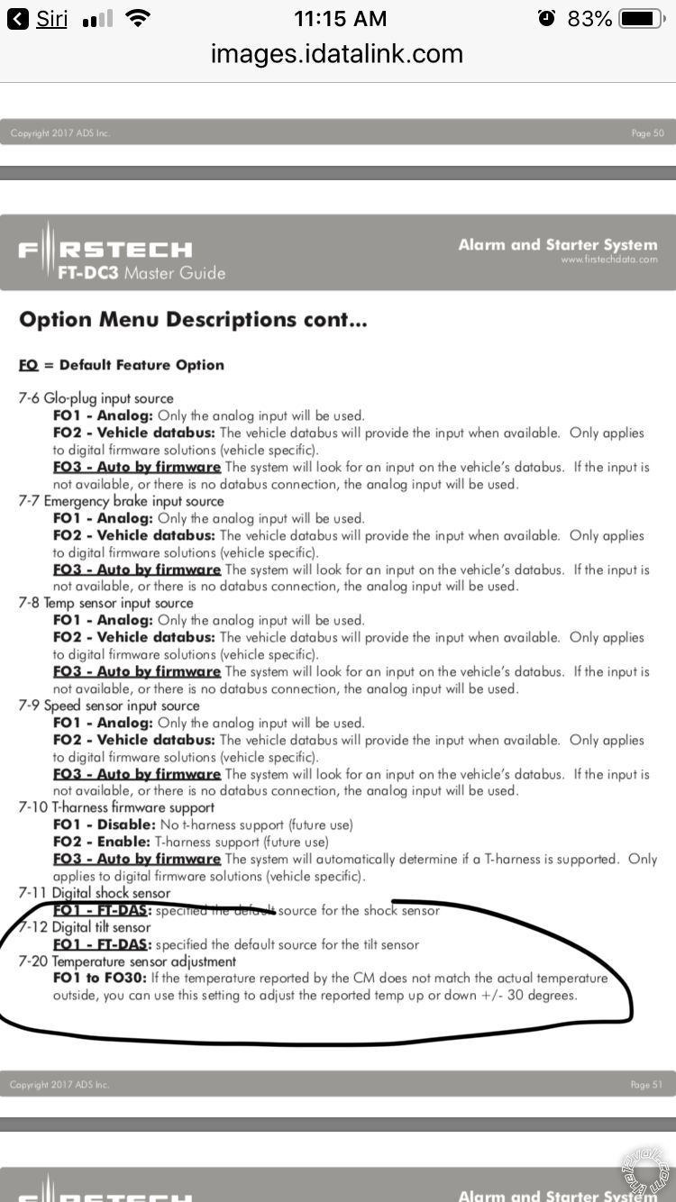

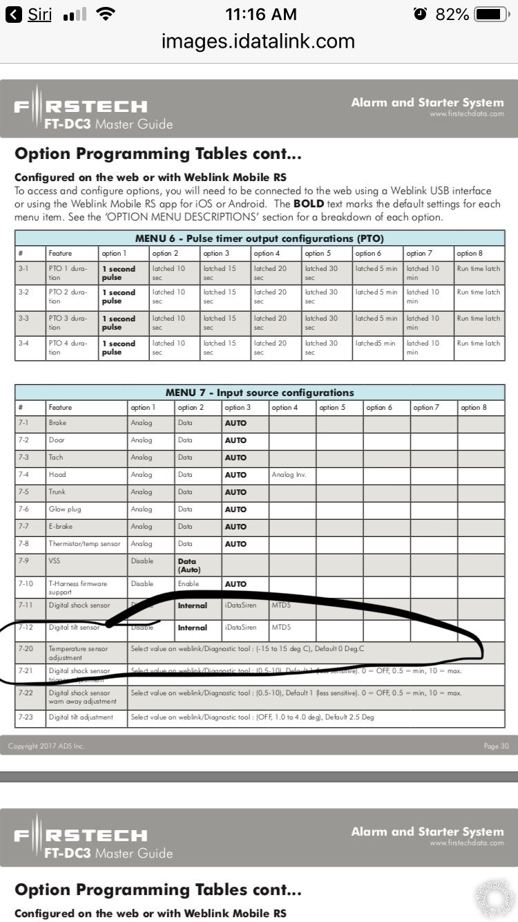

I don’t know anything about arduino and raspberry pi tech but it seems like a pretty good idea. If you wanted to use your original idea with the Compustar unit, there are some fine tuning options that may make it work. This would still require setting the mode on after each time the vehicle is driven. I looked through the Compustar DC3 install manual for the brain that is in my truck and observed some temp probe calibration settings. You said that the lowest hot start default temp of 77 is too high. What if you calibrated the temp sensor probe 3 degrees out to make it think it was 77 when it was actually 74 degrees.
posted_image
posted_image
Steve G
