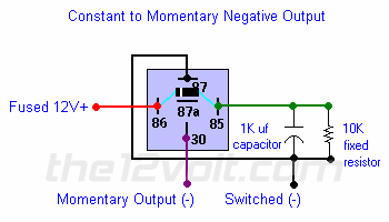

Constant to Momentary Output - Negative Input/Negative Output Relay Wiring Diagram
The capacitor allows the coil of the relay to be energized until the capacitor stores a charge, thus de-energizing the coil. The resistor discharges the capacitor when ground is removed by the switch or 12V is removed from the coil of the relay if using a switched 12V source such as ignition or accessory. You can increase the output time by simply changing the value of the capacitor. This one will give you about a 1/2 second output.
