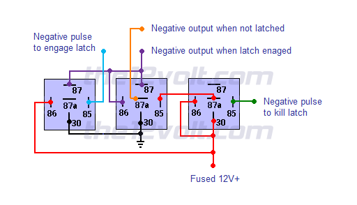

Latched On/Off Output Using Two Momentary Negative Pulses - 2 Negative Outputs - Create Ground While Armed Relay Wiring Diagram
Once activated by the relay on the left, the relay's coil in the middle will stay energized providing a negative output until power to the coil of the relay is broken by the relay on the right. While the latched is engaged, the violet wire will provide a negative output. When the latch is not engaged, the orange wire will provide a negative out.
*This was created for a member who needed a ground when armed output for an alarm that did not have this output. In this case, we recommend using the orange output (not latched), and activating the latch with the unlock output from the alarm and disengage the latch with the lock output of the alarm to minimize current draw when the alarm is armed/locked. "How to create a Ground While Armed" forum topic
