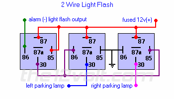

Light Flash - Two Wire (German Vehicles) - Weak Negative Output from Alarm/Keyless Entry Relay Wiring Diagram
Most commonly found on German automobiles, separate left and right parking lamp circuits will require at least two SPDT relays. If your alarm or keyless entry's negative output can not energize the coils of more than one relay simultaneously, then you will need three SPDT relay as shown below.
