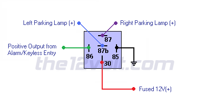

Light Flash - Two Wire (German Vehicles) - Positive Output from Alarm/Keyless Entry (Dual Make SPST Relay) Relay Wiring Diagram
Most commonly found on German automobiles, separate left and right parking lamp circuits will require at least two SPDT relays or one dual make SPST relay as shown below.
