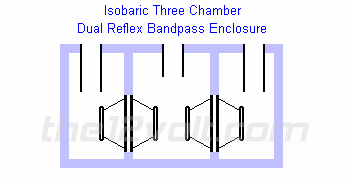

dual bandpass three chamber
iso dual banpass three chamber

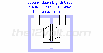

quasi eighth order bandpass
isobaric quasi eighth order bandpass

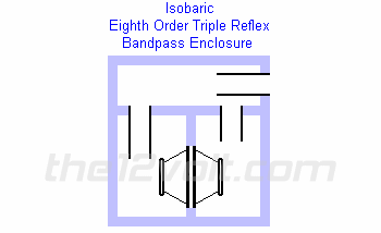

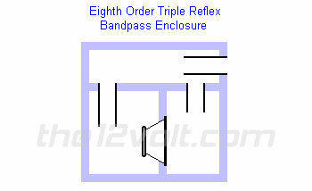

eighth order triple reflex bandpass
isobaric eighth order triple reflex bandpass
