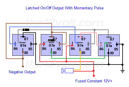

Latched On/Off Output Using a Single Momentary Positive Pulse - Negative Output Relay Wiring Diagram
Similar to the momentary to constant configuration, we can engage and disengage the latched output with a single pulse from a switch or an output from an alarm or remote keyless entry. The first pulse from the switch will engage the latch. The next pulse from the switch will disengage the latch. A positive output from an alarm, remote keyless entry, or other device can be used in place of the switch. While this diagram shows how to create a latch using multiple SPDT relays, you are better off using a single latching relay. Then, if higher current capacity is needed, add a single SPDT or SPST relay.
