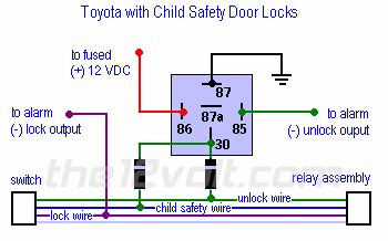

Door Locks - Toyota with Child Safety Door Lock System Relay Wiring Diagram
Locate the child safety wire in the same harness as the lock and unlock wires. This wire will be different colors in different models and will show ground until the lock from the switch is activated. This is a three wire system with an additional wire that must see ground during unlock for all of the doors to unlock. An additional relay may not be required. This will depend on the outputs of your unit. If not needed, connect the unlock output to the wires shown on terminal #30.
