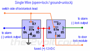

Door Locks - Nissan's Single Wire '91-'95 using 2 relays (Type F) Relay Wiring Diagram
On the '91-'95 300ZX and the '92-'95 240SX, locate the lock/unlock wire in the driver's kick panel or door jamb. When this wire is cut, or opened, the doors will lock. When this wire is grounded. the doors will unlock. If you have positive door lock outputs from the alarm or keyless entry, connect the sides of the coils shown connected to (+)12V DC to ground and the positive door lock outputs to the respective terminals of the relays.
