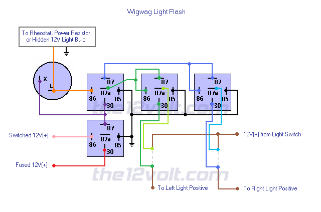

Wigwag Flashing Lights - Positive Input/Positive Output - Isolate Left and Right Lights Relay Wiring Diagram
By placing a load on the flasher with a hidden 12V light bulb, power resistor or rheostat, the flasher will cause the coil of the top relay to energize and de-energize and in turn alternate 12V+ to each of the two top right relays/light for as long as terminal 86 of the bottom relay is connected to 12V+ via a switch or an output from an alarm, keyless entry, etc. The rheostat will allow you to control the flash rate, the power resistor and the 12V light bulb will not. On most German vehicles, if not all, you will not need to isolate the left and right lights from each other via the two top right relays as shown below.
