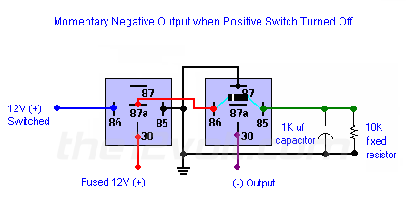

Momentary Negative Output when Positive Switch Turned Off Relay Wiring Diagram
When the switch is turned off, the coil of the first relay is de-energized closing the normally closed contacts and sends 12V (+) to the coil of the second relay. The capacitor allows the coil of the second relay to be energized until the capacitor stores a charge, thus de-energizing the coil. The resistor discharges the capacitor when positive voltage is removed from the other side of the coil when the switch connected to the first relay is turned back on. You can increase the output time by simply changing the value of the capacitor. This one will give you about a 1/2 second output.
