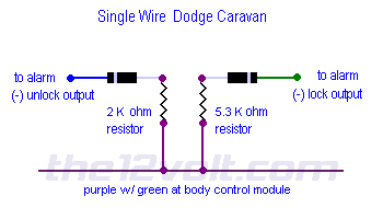

Locate the purple/green wire in connector 3, pin 21 at the body control module. When ground is applied to this wire through a 5.3 K ohm resistor the doors will lock. When ground is applied to this wire through a 2 K ohm resistor the doors will unlock.
Often it is necessary to provide a stronger ground than the negative output of an alarm or keyless entry can provide. When this is the case, use the following relay diagram found here as needed for lock and/or unlock.
Door Locks - Dodge Caravan (2001 - 2005) (Type H) Relay Wiring Diagram
