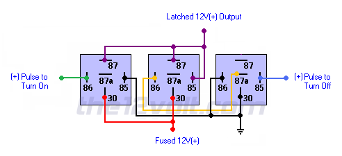

Latched On/Off Output Using Two Momentary Positive Pulses - Positive Output (3 relays, no diode) Relay Wiring Diagram
Once activated by the relay on the left, the relay's coil in the middle will stay energized providing a positive output until ground to the coil of the relay is broken by the relay on the right.
