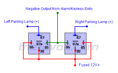

Light Flash - Two Wire (German Vehicles) - Negative Output from Alarm/Keyless Entry Relay Wiring Diagram
Most commonly found on German automobiles, separate left and right parking lamp circuits will require at least two SPDT relays. If your alarm or keyless entry's negative output can energize the coils of two relays, use the following diagram.
