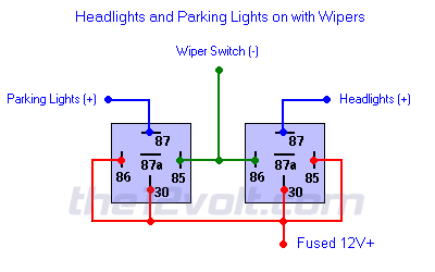

Headlights and Parking Lights on with Wipers - Negative Input/Positive Output Relay Wiring Diagram
In many states, if not all, the law requires the vehicle's headlights and parking lights to be on anytime the vehicle's wipers are on. If you need to supply ground to either the headlights or parking lights, connect terminal 30 to ground on the respective relay.
