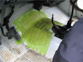

Taking a mould of the transmission hump... I was told it was helpful to wax your masking tape with any old car wax. It seemed to work. My base popped right off nice and neat after the resin had hardened.
1st FG project, lots of pics. Opinions? - Last Post -- posted image.

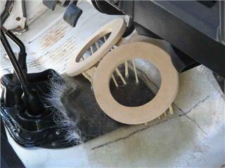

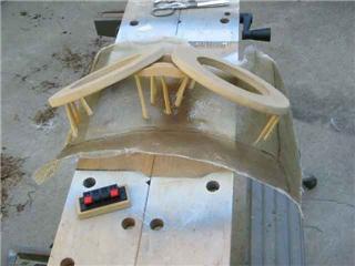

Here's my MDF rings! I was able to attach them firmly to the base using lots and lots of chopsticks cut to lengths, as well as some hot glue. The hot glue is a great choice because it pops off your rings and base easily once your project is nearing completion.

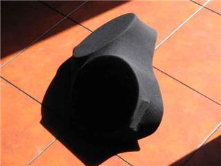

Once my base had its edges sanded smooth, and my rings mounted securely, I stretched black (cotton/lycra) fabric over the "skeleton". I chose this particular fabric for its ability to stretch 4 ways. I love this step! Gives you an idea of how your project is going to look.

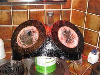

Here we are helping the resin cure under some heat lamps in the kitchen. Please note: I "painted" my fabric with resin ONLY before this step to make my fabric harden and give me a form to lay FG on. (forgot to take a pic of that step, sorry.) This is one of 4 layers of glass on the project.

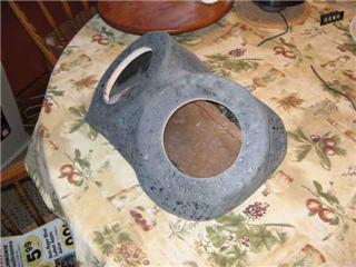

After I felt comfortable with my form's strength, I began sanding! Start out with a coarse paper, as it will take some time. Oh the hours I spent... :) Sanding is KEY to an attractive project. I was told to think of, "how cool it will look and what my buddies will say", and then to remember that while I'm sanding for hours and hours. Here's the form with its high-spots removed, and low spots yet to be filled.

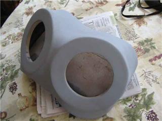

Sanding sanding sanding.... THIS particular bit of sanding is bodyfiller. I purchased some "kitty hair" (bondo and fibreglass) and used it to fill my low spots. I'm pretty sure that regular bondo would be just fine too.
Prime time. After priming you'll notice little pin holes and scratches. Just keep priming and sanding until your scratches disappear, and use some glazing putty to fill in your larger pinholes.

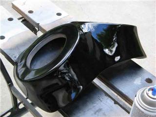

I used a rattle can to lay on 3 coats of black enamel. If you can use a real gun, I'm told it's way better. Looks pretty good to me though....

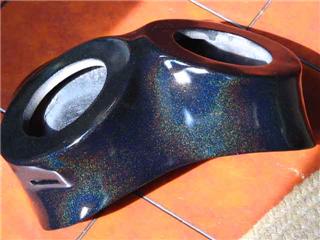

I wanted my project to be somewhat stealthy, as it will be highly visible in the front of my Jeep, but I still wanted it to be somewhat flashy. I applied some rainbow flake over the enamel and finished it with a couple coats of clear. Fancy Shmancy... Not pictured is the poly-fill I put in the enclosure before I screwed the speakers in. Not too much, just enough to deaden sound a bit.

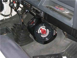

And here she is. It might look like it's touching the vents and shifter, but it's not. Just VERY tight clearances. I attached it to the transmission hump using velcro on the base, and it works very well. The speaker terminal allows me to disconnect it easily, should I have to park for a long period of time (vacation or something else....) and the velcro lets me yank it out no problem. This is kind of a crappy pic, but it looks KILLER in the sunlight.
Sounds great, adds tons of midrange and crisp highs. Hope this helped jeepsters looking for better sound!
