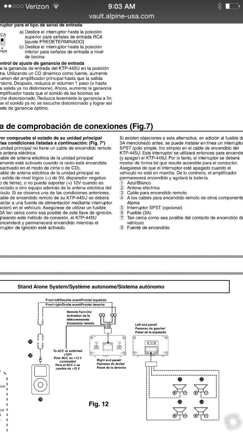

Simply put you need an adapter that utilizes the charging port/av out or the aux/headphone plug on the iPad that gives you rca out and you will have to split the rcas to go to your amps and use a bass knob for the sub control. Pac or many other vendors sell the iPad adapters to rca that also give you charging. There are sooooo many levels of designing a system like this depending on budget the sky is the limit.

How to wire a tablet as a head unit -- posted image.
Would I split the L/R RCA out from the 3.5 adapter for my Subs and the other for the KTP445u Amp?
