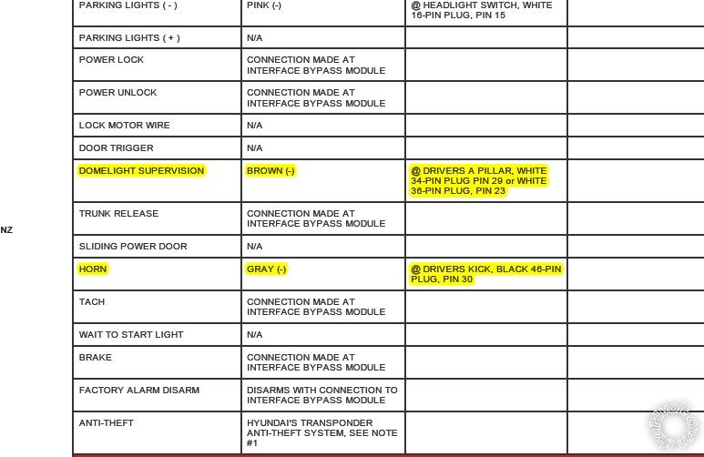

I am trying to install 4 window roll up \ down on my vehicle santa fe 2013 -2014 regular key (include security system viper 5706v and DBALL2 bypass).

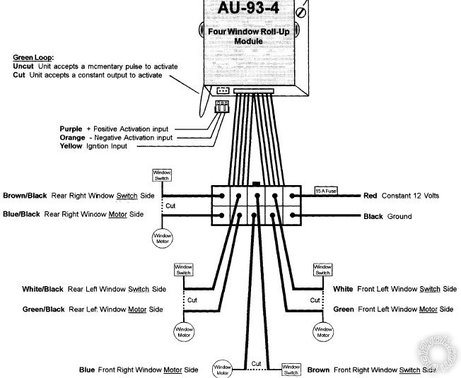

I am decided when I review some topics in the12volt concerning window roll up to buy module (Omega AU-93-4 module) for roll up windows when engine off and AUX for roll up \ down , but , I am still confused for some issues , before starting install the mentioned device, herein my questions ;
1-Comfort closure in viper 5706v diagram (can I wire it to my      vehicle directly by using relay for example?)
If I can’t wire it directly that’s mean I most use module, am I right?
2-I cannot find location of power window harness to connected wire module with it?

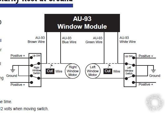

3-If I find it, should I cut the wires as diagram shown in (attached Photo) or viper – bypass play any role here to avoid cutting wire in all windows?

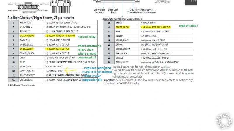

4-To connect Aux1 (-) 200mA output (WHITE/ VIOLET) as diagram says it should be use or connected to relay ( how can I connect the wires into relay and where it supposed connect the wire lead from relay I mean in which harness and where is located )
5-What is type of relay I should use in the above mention connection also what type of relay should be used for dome light and horn (as mentioned in diagram of viper see below )
6-Where the location of door is trigger / power window main switch?
