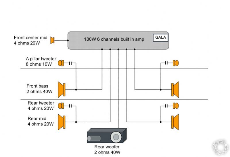

Hi guys,
New here, really don't know much about car audio.. I have a rather dumb question I guess, my 2015 Audi S3 has the factory 10 speakers setup (9VD Audi Sound System) I wanted to add the factory B&O upgrade's tweeter and mid to my existing system but not sure if the built in amp could handle it. There's a shop who claimed to have done many setup like this but I'm just not sure so wanted to get some advise before I blown any amp or speaker...
The is the current standard Audi Sound System setup
Stock Audi Sound System setup -- posted image.

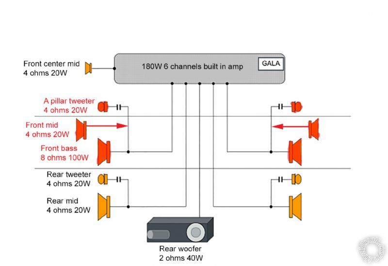

This is the intended add on in red. The standard 8 ohms 10W tweeter will be replaced by the 4 ohms 20W. And the mid will tap into the tweeter/bass at 4 ohms 20W in parallel. Would the 180W built in amp be able to handle this or am I pretty much looking for trouble?
If this is indeed a very stupid idea, would JUST replacing the 8 ohms 10W front tweeter with 4 ohms 20W works? Thanks and sorry about the stupid questions...

Stock is 1.6 ohms for the front, if you hook up the way you have shown you will be a 1 ohms, and if you replace the mid you will be a 2 ohms. The safer bet is to replace the mid. The output will be a little lower, but you don't risk going below what the amp can handle. If the amp is 1 ohm stable then yes you can add the mid and replace the tweeter. IF not then replacing the mid will be the safer way to go.
Thanks for the reply!! But let me just make sure, you meant that ADDING the mid to the existing tweeter/bass in parallel is actually safer than replacing the tweeters? And I should only add the mids and replace the tweeters only if I'm sure the amp is 1 ohm stable? Thanks again!

If you replace tweeter and add the mid in parallel like you second diagram, that would be a 1 ohm load per front channel.
Otherwise replacing both (the tweeter and bass with the mid) would be a 2 ohm load per front channel.
The only way to match the original impedance exactly with 3 speakers(tweeter,mid, and bass) would be by having one 8 ohm, and two 4 ohm speakers all in parallel.
THIS WOULD BE A 1.143 ohm load.
Correct

Posted: August 12, 2016 at 6:32 AM / IP Logged Link to Post Post Reply Quote larbel
Thanks for the detail explanation 😬 I could keep the 8 ohms tweeter, add the 4 ohms mid, and get a 4 ohms bass to keep it at 1.6 ohms, but do you think 4 ohms mid and bass would be better than a 2 ohms bass alone?

Well, I'm mostly happy with the current system except for wanting a little bit more mid up front. Right now, there trebles are located inside the A pillar, and a center dash mid, then the front door only has a bass inside so the clarity although isn't bad, it's a little bit more "forward" then I would like. Adding the mid to the front door would be the best solution but I'd have to give up some bass and not really sure how much tradeoff there would be.. Is there such a thing as a little small size power amp for application like this running only a pair of speaker?

Posted: August 14, 2016 at 4:25 PM / IP Logged Link to Post Post Reply Quote lurch228
The only other option that I can see working is too series the new 4 ohm tweeter and 4 ohm mid then you would maintain the same resistance as the original 8 ohm tweeter.
Connect POS from original tweeter to POS of Mid then NEG from mid to POS of new tweeter and NEG of new tweeter back to original tweeter NEG.
This should work as long as there is no crossover in the works. IE the tweeter is using a inline Capicator for cross off.

Thanks again!!! I just found out the stock B&O upgrade front bass is 8 ohms! So if I fit the B&O tweeter/mid/bass it would make it 1.6 ohms as well! But in your opinion, since my amp is only 180W, and given the B&O are SLIGHTLY better quality, do you think it would yield better sound? Which of the below would you think is better?
Standard setup
B&O Tweeter/mid/bass setup
lurch228
Silver - Posts: 1,338
Joined: August 08, 2012
Posted: August 15, 2016 at 6:37 PM / IP Logged Link to Post Post Reply Quote lurch228
The more speakers reproducing the full sound spectrum will have better sound clarity as you are narrowing the width of sound that any given speaker is trying to output.
