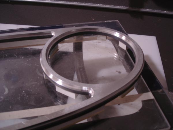

Cut/rout the parts that you want make out of aluminum out of ¾ MDF. Make them perfect. Then rout a duplicate part out of ¼” PVC. You can get it here www.tapplastics.com. Then rough cut your part from 1/8” – ¼ “ aluminum. Use your PVC part as a guide. I use double stick tape to laminate the PVC part to the aluminum sheet. Then I rest the base plate of my jig saw directly on the PVC part. This way the aluminum chips do not get wedged between the jig saw base and the aluminum base and dig into the surface of the aluminum sheet. Then adhere the MDF- PVC-aluminum stack to a sheet of plexi or a router shield. Apply cutting oil to the surface of the aluminum that the router will be cutting. Only apply oil and rout a 12” section or so at a time. Any more than that and you risk the oil eating a way at the double sided tape and the aluminum breaking away while you are routing. Take care not to get oil on the tape edge. Don’t use spray type oils!

In spite of the long explanation I have provided here this is all quite simple and easy to do given a little experimentation doing so. I have tried to include enough info to keep you out of any pitfalls. PM me with any questions. Good luck.
custom console for 73 nova - Last Post -- posted image.
