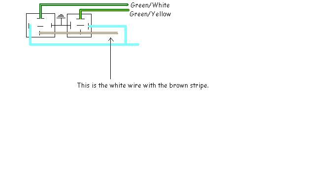

You will have to use 2 relays to replace one of these relays. The GREEN / WHITE and the GREEN/ YELLOW are connected together when the relay is energized, when the relay is at rest those 2 wires are not connected. I will draw you a picture. Might be later tonight or in the morning.

Platinum - Posts: 13,723
Posted: June 07, 2008 at 9:39 PM / IP Logged
identify this relay. - Page 2 - Last Post -- posted image.
The above picture will replace one of the older relays. You will have to build 2 of these.
