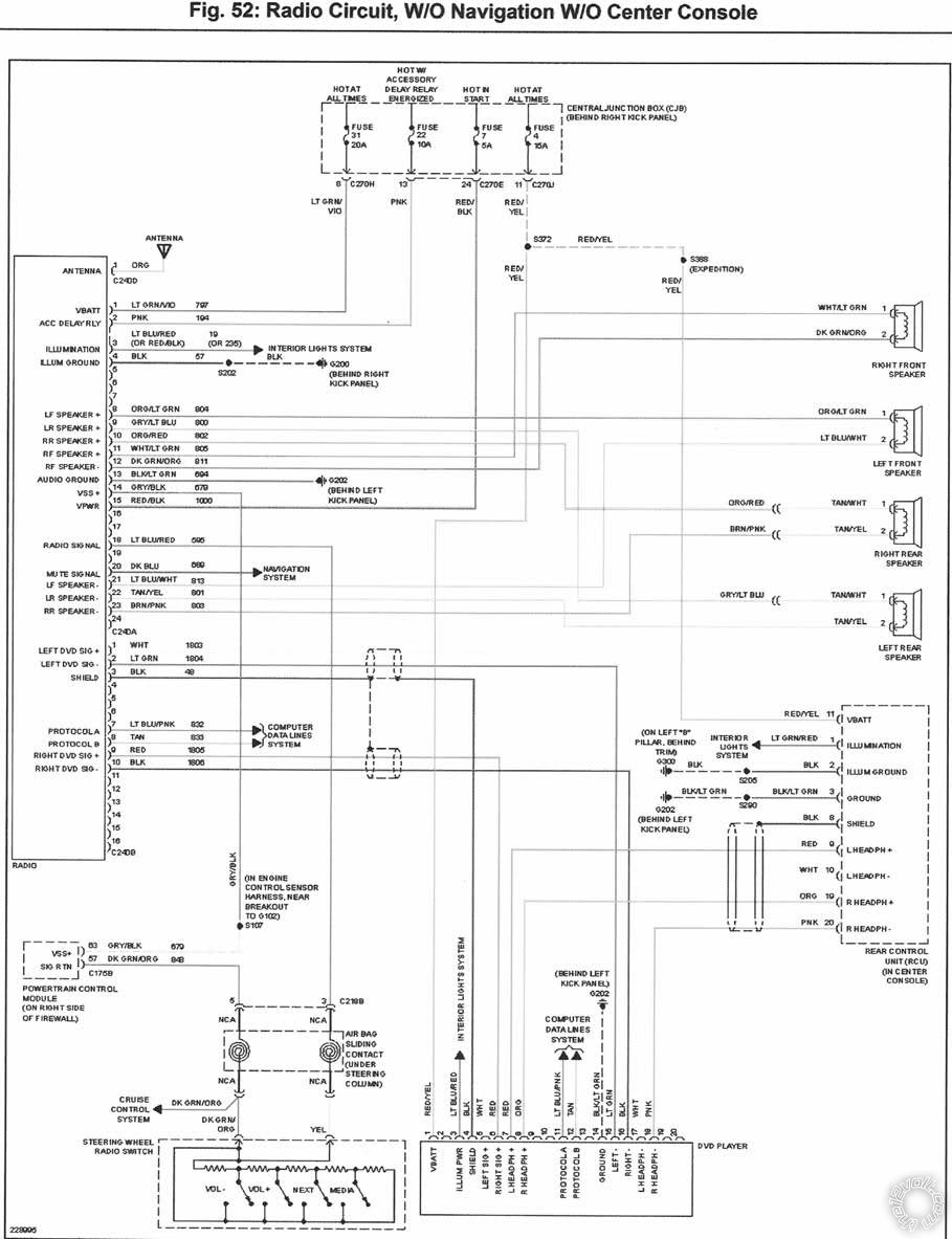

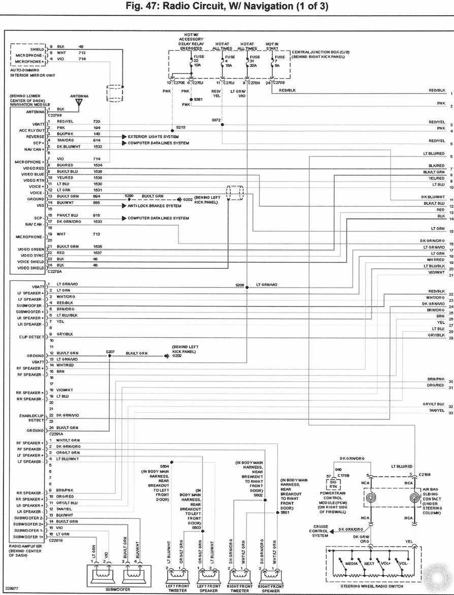

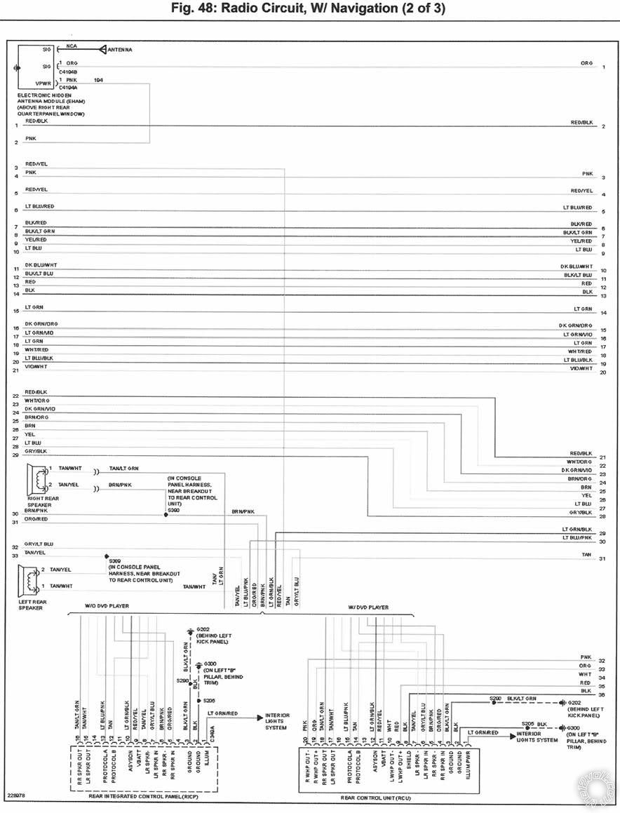

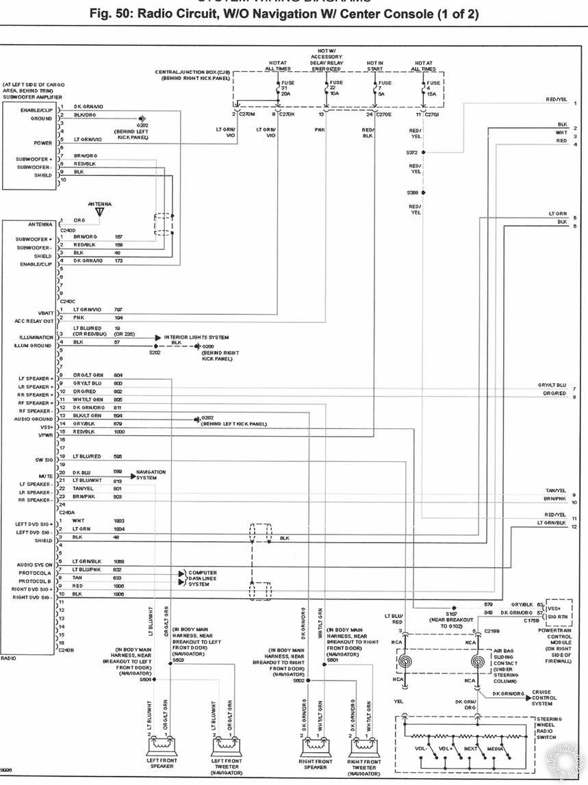

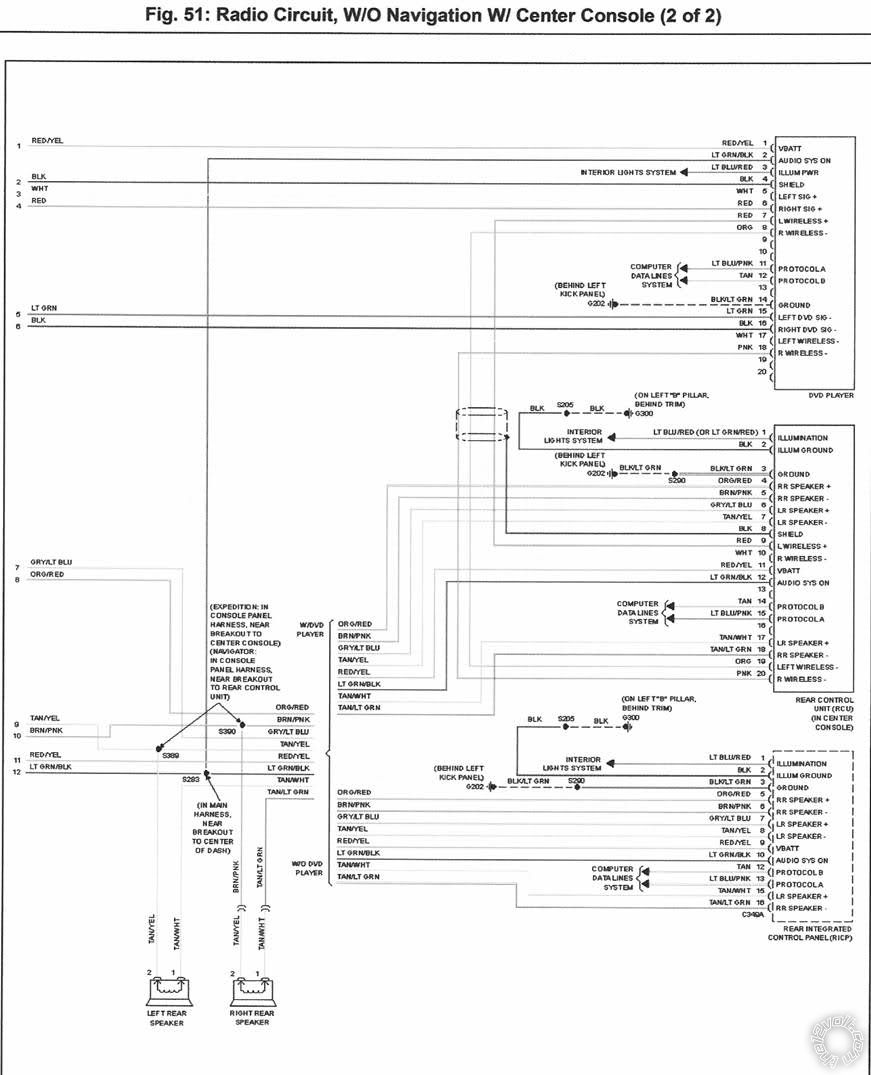

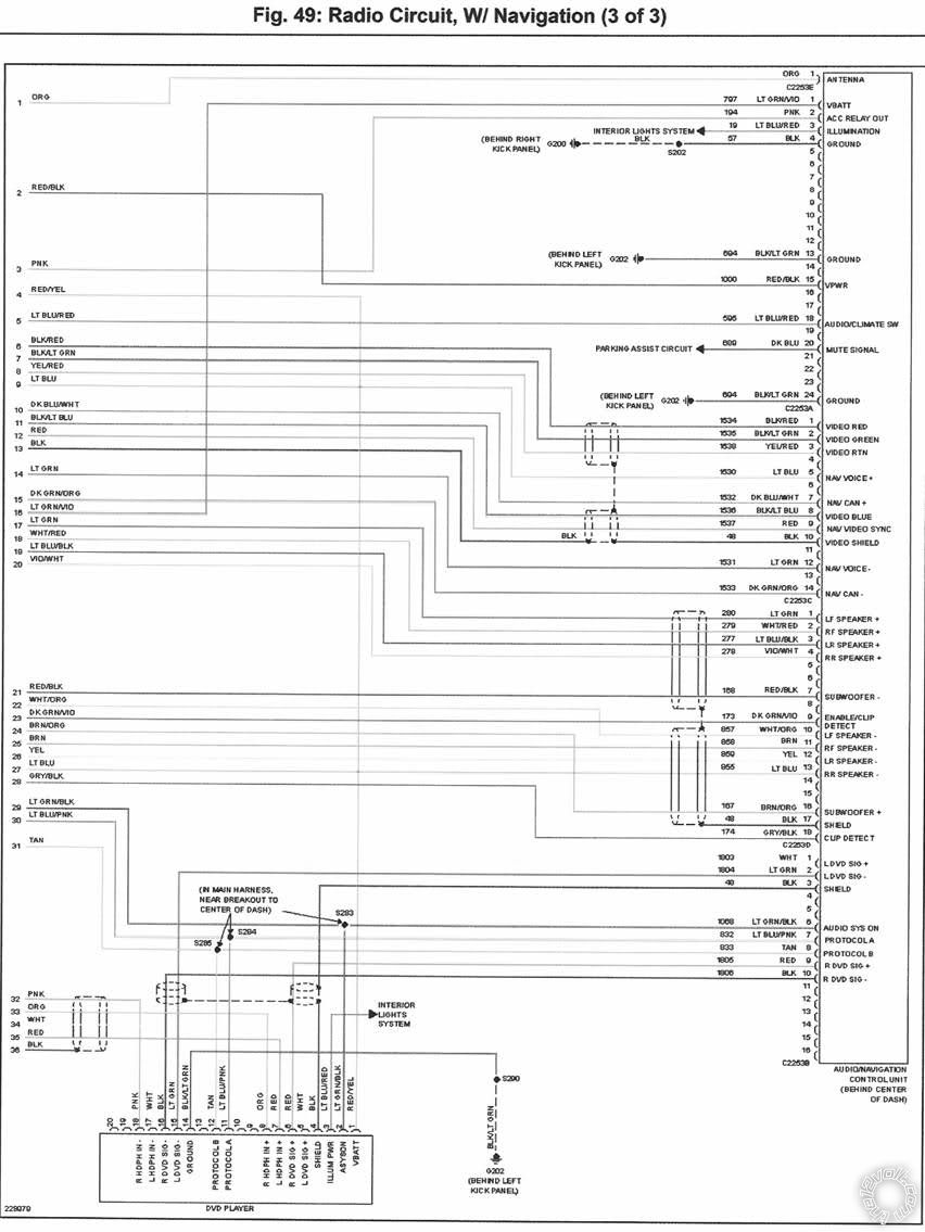

Here you guys go ... at my expense!!! 2006 Lincoln Navigator Stereo/Alarm Wiring - Page 2 - Last Post -- posted image.
