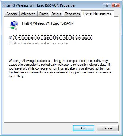

Bluetooth is an option on that unit. Do you have bluetooth? I read a couple things about the unit but did not notice if there was an Infrared Port on the unit. If it has Infrared, try covering the sensor to see if that helps. I have seen cases where the operating system failed to write to the bios, go to device manager and enable the wake on feature on both adapters, restart if it wants to. Then go back and remove the checks, restart again.
I tried to cover my laptop with a blanket and a bunch of other stuff but it still turned on. I checked the event viewer, didn't see a wireless viewer anywhere but nothing significant showed up.
I can't turn the wake on on and off because the box can't be checked. I turned off the bluetooth on my laptop which didn't help.
This problem makes absolutely NO sense to me. I would think it was a software problem but it only happens at my apartment which implies wireless or bluetooth. It only happens after six hours which doesn't make sense if it is wireless or bluetooth. I turn off the wireless on my laptop before I put it into hibernate but it still happens. It only when I am sleeping. It doesn't happen when I'm gone during the day even if it sits for six hours. I have NO clue anymore. By far the strangest problem I have ever had.
Tommorrow I think I'm going to try to totally isolate my laptop. Keep it somewhere where I know it can't get a wireless connection and see if that helps.
Thanks for the help but I think I'm going to contact Microsoft next. Contacting HP will take forever to figure it out so maybe Microsoft will know.

When you say it won't let you put a check in the box, where is this?  In Device manager on the power management tab of the properties applet of the wireless or ethernet?    I know you said earlier that you went into the bios and turned off all of the wake on options.   Go back there and turn them all on.  Restart and turn all off and restart again.  Now go back to wherever it would not let you put a check, see if it will now.
For my wireless adapter it won't let me check or uncheck that box. I checked then unchecked the others which didn't help.
