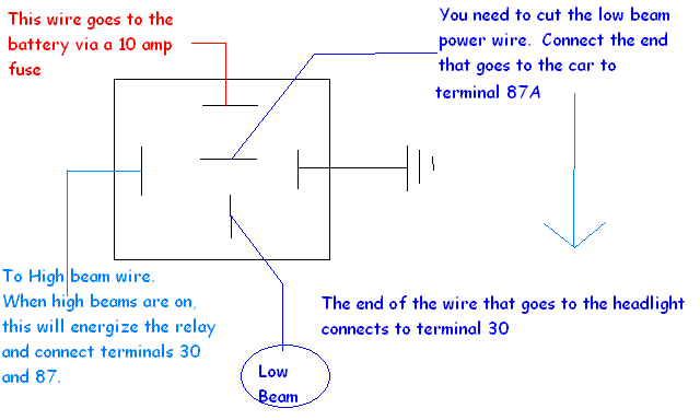

Sorry if this has been asked before, but I did not see it. I have a 2004 Chevy Tahoe and the low beams go out when the high beams are on. They make a kit for converting them so all are on when on high beam, but it is very expensive and I thought I could do it myself by using diodes or relays. Anyone ever do this before and if so how??
Thanks, Kim

2 Headlights to 4 - Last Post -- posted image.
A different Diagram here
Another one Here Too.

I finally got around to hooking up the relays on my Tahoe and they work great!! Thanks i am an idiot.
