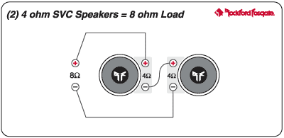

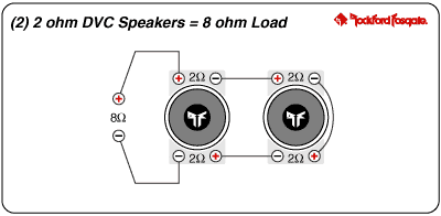

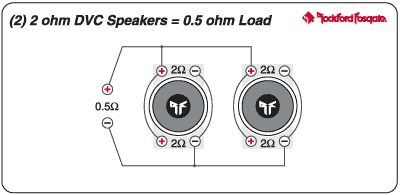

(Courtesy of Rockford Fostgate Wiring Wizard)
wireing quad coils - Last Post -- posted image.

there 1.17ohm coils......i just want to know how to calculate them and the diffrent ways to do it .........wv i said QUAD coils not dvc i know how to do that but thanks anways
