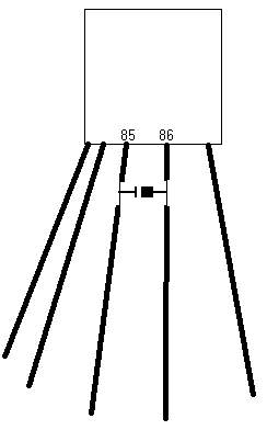

What I'd like to know is how to install the diode across the coil. If I have a relay, and a harness connected to it (so I have 5 wires hanging down), can I just splice open 85 and 86's wires, and put the diode in there? Like in the picture below...rough example.

Posted: April 24, 2003 at 3:40 PM / IP Logged
yes, that's fine.. then make sure to use 85 as positive..

this may be a stupid question but does it make a difference if you put the diode where the picture shows(above) or on the actual pins on the relays?

Posted: April 24, 2003 at 5:32 PM / IP Logged
no, it doesn't matter.. just be careful not to melt the relay if you solder.. Diode across coil on a relay? - Page 2 - Last Post -- posted image.
