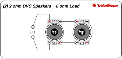

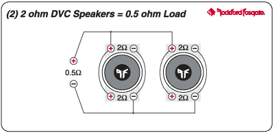

Keep in mind your wiring options for DVC's when you are buying subs and amps...
You can wire 1 2ohm DVC into a 1 or 4ohm load
You can wire 2 2ohm DVC's into a 0.5, 2, or 8ohm load
You can wire 1 4ohm DVC into a 2 or 8ohm load
You can wire 2 4ohm DVC's into a 1 or 4ohm load
Let me know if you need diagrams

Aah, cheers Squirrel, that cleared up alot of things. I guess where i was orginally coming from was whether a 4 ohm DVC sub would take a 2ohm load ok. Those diagrams would come in very handy though, thanks alot.

Here's the diagrams, hope they help...
2004’s 2ohm 400w + amp & DVC n VC - Last Post -- posted image.
