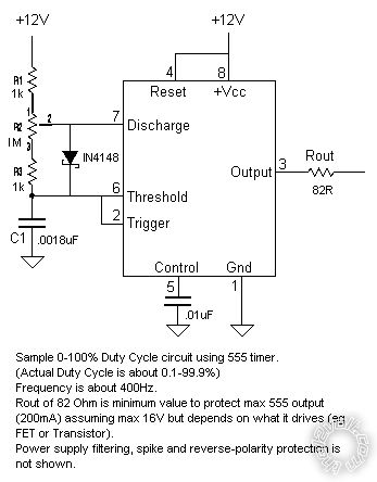

Otherwise a PWM circuit as below but set to 40%-60% duty cycle feeding a 20-80A MOSFET or two....

To dim your halogens or HIDs, you need a circuit that switches on and off quickly - aka a PWM circuit. However, HID supplies may not tolerate such switching. (Those with real ballasts are probably ok.)
You could try a 50% duty cycle multivibrator made from transistors, 1 or 3 inverter gates etc.
Or you could use the 555 circuit above which is settable from 0.1% to 99.9$ duty cycle (on time to off time) to dim LEDs, fluorescent lamps, etc. For a fixed duty cycle, R1 & R3 could be changed and the pot R2 omitted. The Rout is connected to a MOSFET of 20A or higher rating that grounds or powers the beams.
BTW - this switching is fast - like a few hundred or or several kilo Hertz. It cannot be done with relays.
Or you google and find a link like hamsar...ProductType=Electronics etc. (Again - note the "solid state" labels - they are NOT resistors. Nor will they merely reduce voltage.)
