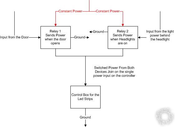

I have a 2004 Corolla S. I am going to be installing some led strips in the foot wells inside the cabin. I would like them to come on when the doors are opened as well as when the front headlights are on.
I know that i can do one or the other very easily by using a simple relay to trigger when the door is open or when the running lights are on. However i do not know how to do them both. Can i simply attach the switched power of both relays to positive lead on the led strip or will that cause some sort of backwards flow problem.
I have attached a diagram of what i was thing of. Please let me know if i am going about this the correct way.
interior led lighting - Last Post -- posted image.
Is there an easier way to do this?
Thanks

Posted: November 29, 2010 at 7:37 PM / IP Logged
Assuming the door is a grounding switch, it can ground a relay (horn-type relay else 85; with 86 & 87 to (fused) +12V; and then 30) to power the LEDs.
And either a diode from the headlight circuit direct to the LEDs, else to 87 if the above if an SPDT relay is used and any changeover break is acceptable.
A diode may be needed from the door switch(es) to the relay coil (85) if dimmer ot other circuits are involved.

Alright i am by no means an expert at any of this. If i understand you correctly i just need to add a diode between both relays the the led controller box to prevent the flow of electricity backwards.
Is that correct?

Posted: November 30, 2010 at 8:39 PM / IP Logged
What relays?
You don't need one if a possible perceptive break when switching from LEDs on with headlights to LEDs on for open door & close again is not a problem.
Depending on the LED current, a capacitor could solve that break (it's probably only ~20mSecs).
And otherwise, I only proposed one relay - but that assumed the door input was GROUND.
If the door input is +12V, then you only need 2 diodes.

Thanks for the response. This is the scenario i was thinking about. I get in the car at 7 PM when it is still light out. My headlights will not be on. I want the led lights to come on because the door opens. Because at other times it may be dark out so i would see them. I am driving now and at 7:30 it is now dark enough that i would notice the led, so i turn my cars headlights on and that would then trigger the led to come on as well.
In order to get the separate triggers i would need 2 relays with the 2 diodes between the controller box and the switched power correct regardless if the door is grounded or positive
